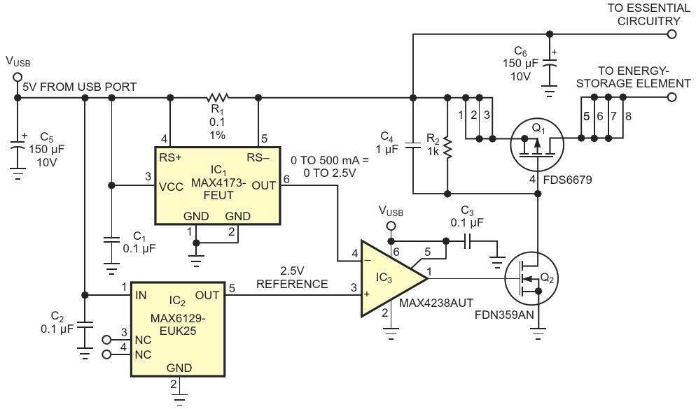

This circuit continuously monitors the total current drawn from the USB port and dynamically adjusts the storage-element current to avoid exceeding the port's maximum output capability
