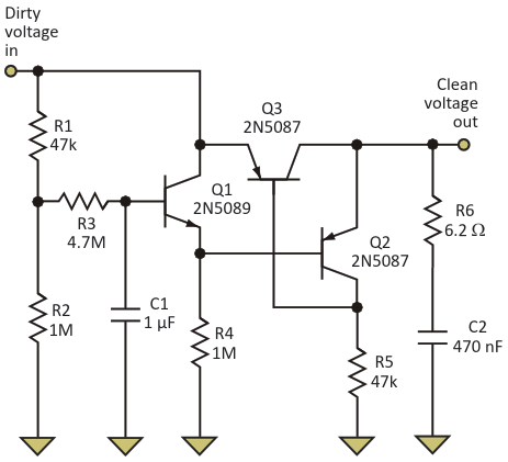

The ripple-eater design, essentially a filter with a follower, rejects as much as 40 dB in ripple and continues operating even as the supply voltage drops to low levels
