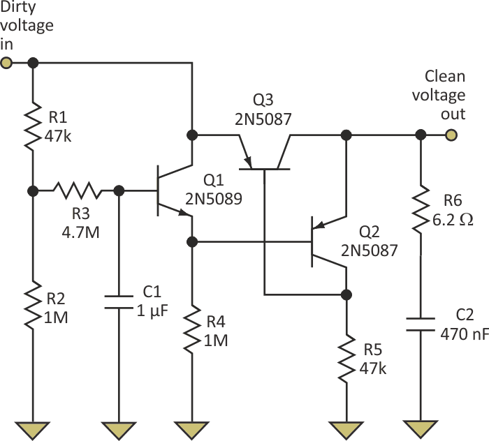

The ripple-eater design, essentially a filter with a follower, rejects as much as 40 dB in ripple and continues operating even as the supply voltage drops to low levels.
Figure 1. The ripple-eater design, essentially a filter with a follower, rejects as much
to low levels.

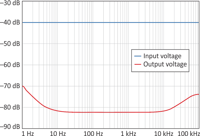

One well-known ripple-eater design that has been popular among audio enthusiasts is available in kit form. That design, though, is relatively complex and operates by bucking the ripple. The simple ripple-eater shown here (Fig. 1) is far simpler and offers about 40 dB of low-power cleaning at audio frequencies (Fig. 2), making it useful for such functions as pre-amplifiers.
With the transistors shown in Figure 1, the power-supply rejection holds well beyond the audio band.
Figure 2. With the transistors shown in Figure 1, the power-supply rejection holds
The design simply comprises a filter buffered by a follower. A voltage divider (R1 and R2) provides headroom for subsequent regulation. A low-pass filter (R3 and C1) provides a clean voltage that an emitter-follower (Q1 and R4) buffers, adding one diode-drop of offset. A pass transistor (Q3) and feedback amplifier (Q2) provide gain and cancel the diode drop of Q1.
This circuit has sufficient gain to require compensation, which R6 and C2 provide. The voltages at the base of Q1 and at the output are essentially equal, so the transistors form a fed-back follower.
The ratio of R1 and R2 should be chosen to set the ripple-eater’s output far enough below the input so the output is below any troughs in the input voltage. Otherwise the circuit will “drop out” like any other regulator.

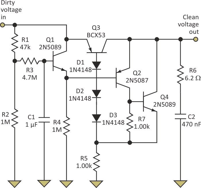

A higher-power ripple-eater augments the simple design with an additional transistor (Q4) to increase gain.
Figure 3. A higher-power ripple-eater augments the simple design with an additional
If more power is needed than the simple ripple-eater can provide, using a composite transistor in the feedback will provide more gain (Fig. 3). The higher-power version adds Q4 and R7 to increase gain beyond what Q2 alone provides, and the diodes (D1 to D3) increase headroom for the composite transistor’s operation. The result has greater ripple rejection in the audio band (Fig. 4) but loses effectiveness in the high-frequency band.
