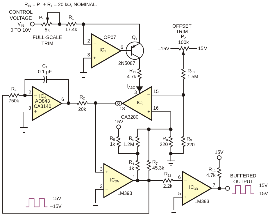

uses an OTA and a hysteretic comparator to deliver a reciprocal (1/x) response to the control voltage

Figure 2. This V
CO
