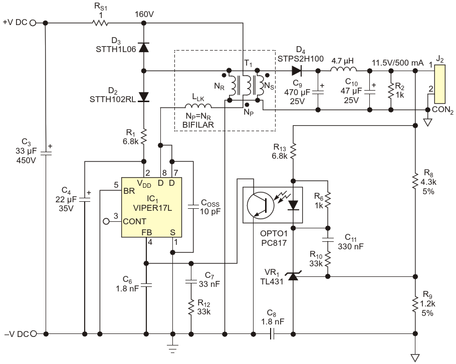

A bifilar demagnetizing winding …
A bifilar demagnetizing winding added to a flyback transformer shunts the power switch output capacitance, C
OSS
; steers the leakage energy back to the supply rail; and clamps the switch voltage during the turn-off transition. Then, switched to
Todor Arsenov
Leakage-Energy Recuperating Winding Self-Supplies a DC/DC Converter
