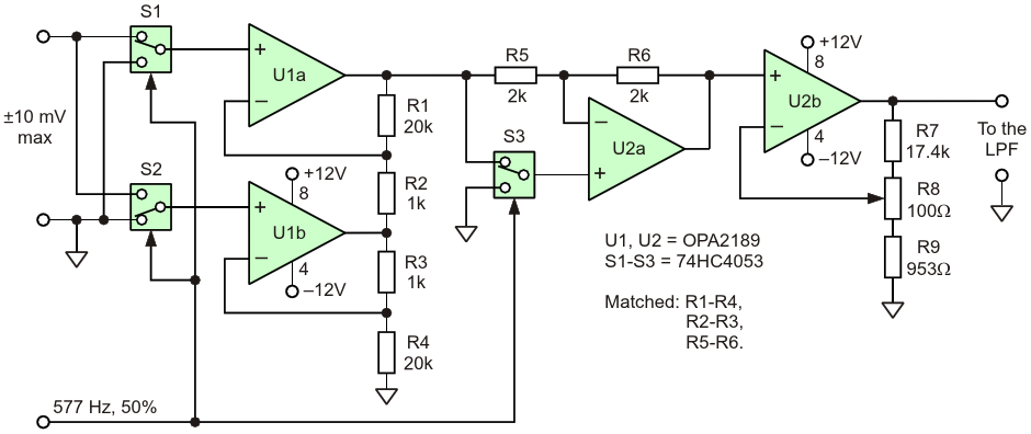

Circuit schematic of part …
Circuit schematic of part of the amplifier (filter is presented separately below)

Precision synchronous detection amplifier facilitates low voltage measurements
Figure 1. Block diagram of the amplifier
Figure 2. Circuit schematic of part of the amplifier (filter is presented separately below)
