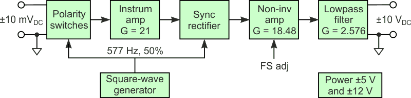

Figure 1 shows the block diagram of the amplifier. It provides a fixed gain of 1000 split between an instrumentation amplifier, an adjustable non-inverting amplifier and a lowpass filter. Polarity switches and the instrumentation amplifier convert the DC input into a bipolar square-wave signal, so the synchronous detection technique can be applied.
Block diagram of the amplifier.
Figure 1. Block diagram of the amplifier.

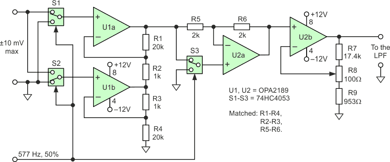

Figure 2 presents the circuits of the first four units of the block diagram. High quality op-amps provide ultra-low offset voltage, very low noise and slew rate of 20 V/µs. All resistors have 1% tolerance, but the R1 to R6 resistors are matched in pairs to 0.05%.
Circuit schematic of part of the amplifier (filter is presented separately below).
Figure 2. Circuit schematic of part of the amplifier (filter is presented separately below).
