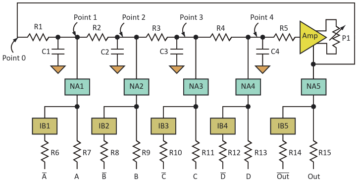

The fixed-frequency, fixed-multiphase generator …
The fixed-frequency, fixed-multiphase generator uses repetitive blocks to provide stepped phase differences relative to the original waveform

Op Amps Build Simple Multiphase Signal Generator
Figure 1
25 Kb
Figure 1. The fixed-frequency, fixed-multiphase generator uses repetitive blocks to provide stepped phase differences relative to the original waveform
Figure 2. Formed by IC1a and IC1b, the basic signal generator uses phase-shifted versions for the other outputs, each of which is buffered by a non-inverting and inverting amplifier to provide the additional outputs
