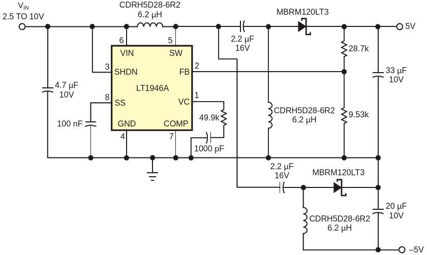

A simple circuit produces …
A simple circuit produces -5 V from a single positive input without the need for a transformer
David Kim
Transformerless dc/dc converter produces bipolar outputs
Figure 1
27 Kb
Figure 1. A simple circuit produces -5 V from a single positive input without the need for a transformer
Figure 2. This graphic shows maximum output current versus input voltage for both outputs or a single output
Figure 3. These curves show the regulation of the -5 V supply as a function of the 5 V output current (a), and the regulation of the same output as a function of the -5 V output current (b)
