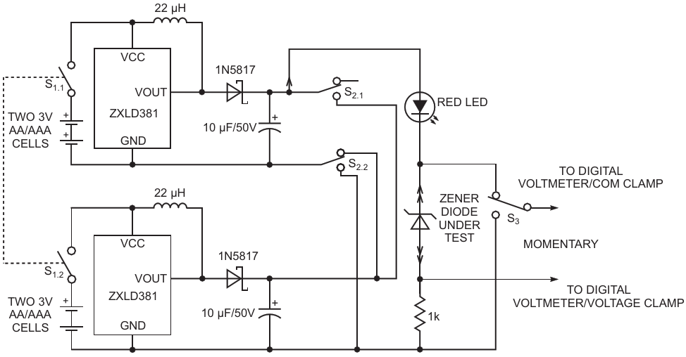

Two LED drivers operating in series or parallel let you boost zener voltage or current

Circuit lets you measure zener voltages and test LEDs

Figure 1. Current through a zener diode creates a fixed voltage across the device
Figure 2. An LED driver provides current for the LED under test
Figure 3. Two LED drivers operating in series or parallel let you boost zener voltage or current
