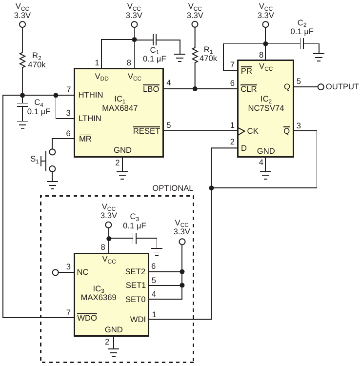

This simple electronic circuit uses a momentary-contact pushbutton switch, S
1
, to replace a more expensive mechanical push-on/push-off switch

Electronic circuit replaces mechanical push-push switch
Figure 1. This simple electronic circuit uses a momentary-contact pushbutton switch, S
1
Figure 2. Repeatedly pressing the circuit's momentary-contact switch toggles the circuit's output on and off. After a preselected interval, an optional watchdog timer resets the output to the logic-low state
