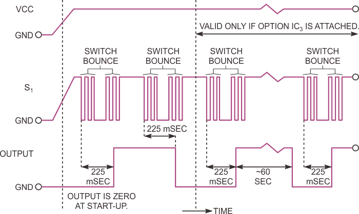

A supervisory microprocessor, IC1, serves as a combination switch debouncer and intelligent controller. Applying power holds IC1’s /LBO output (Pin 4) low, which in turn resets flip-flop IC2’s output to a logic-low state (off) (Figure 2). Pressing the NO momentary-contact switch, S1, evokes a pulse from the /RESET output (IC1, Pin 5), which triggers IC2’s CK input (Pin 1) and toggles IC2’s output to a logic-high state (on). Pressing the switch a second time triggers another /RESET pulse that toggles flip-flop IC2’s output to a logic-low state (off).
Repeatedly pressing the circuit's momentary-contact switch toggles the circuit's output on and off. After a preselected interval, an optional watchdog timer resets the output to the logic-low state.
Figure 2. Repeatedly pressing the circuit’s momentary-contact switch toggles the circuit’s output on and off.
You can add an optional watchdog timer, IC3, to reset IC2’s output to the logic-low state after a user-selectable interval as long as 60 sec. You can select shorter reset times using IC3’s programming pins: SET0, SET1, and SET2. The entire circuit costs about $2 (1000) and occupies a pc-board area that's no larger than its mechanical counterpart.
