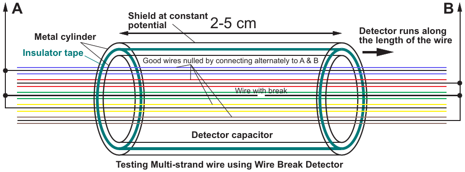

Detect wire breaks with unusual CMOS gate circuit
Figure 4
17 Kb
Figure 1. Transparent latch using ordinary CMOS gates. Data in is "D" and enable is "E"
Figure 2. Schematic diagram of wire break detector using CMOS memory cell (shown in broken box). If using the CD40106, only one gate is needed for the oscillator (Schmitt inputs). An additional gate can be put in series with the memory cell G5 and G6 to form a comp
Figure 3. This shows how the LEDs respond to sleeve position
Figure 4. Suggested connection for a multiconductor cable
