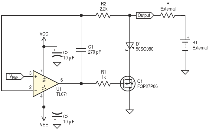

Active shunt voltage limiter outshines Zener. Part 1
Figure 1
30 Kb
Figure 1. Schematic of a simple positive shunt voltage limiter
Figure 2. Current versus voltage for circuit in Figure 1, high current, note the square knee
Figure 3. CCurrent versus voltage for circuit in Figure 1, low current, showing current increase when nearing common mode range limit
