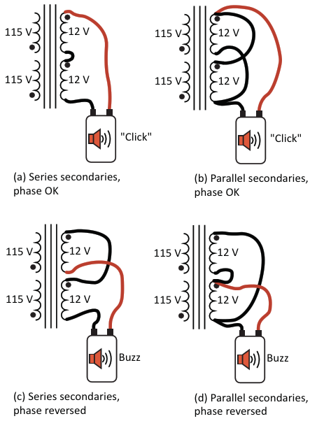

Shown are some of the tests that the continuity tester can make on a dual-primary/ dual-secondary transformer without having to connect it to the mains
