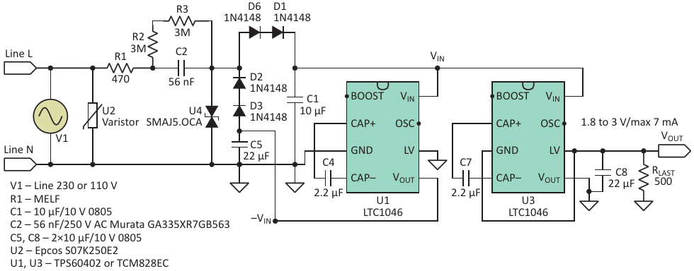

The modified capacitive converter …
The modified capacitive converter without bridge rectifier brings a fixed ground connection

Topology implements updated version of non-isolated capacitive power converter
Figure 4
27 Kb
Figure 1. The basic capacitive converter uses a diode rectification, Zener diodes, and capacitors but has no regulation
Figure 2. The modified capacitive converter with bridge rectifier adds additional regulation and protection
Figure 4. The modified capacitive converter without bridge rectifier brings a fixed ground connection
