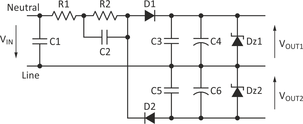

In the well-known design of a capacitive power supply, capacitor C2 accommodates the ac mains voltage to a voltage level suitable for the application, while R1 and R2 are connected to limit inrush currents due to the capacitors (Fig. 1). The voltage is then rectified by diodes D1 and D2 and regulated using Zener diodes Dz1 and Dz2 along with output capacitors C4 and C6. The amount of output current depends on the impedance of capacitors at 230 V/50 Hz or 110 V/60 Hz.
The basic capacitive converter uses a diode rectification, Zener diodes, and capacitors but has no regulation.
Figure 1. The basic capacitive converter uses a diode rectification, Zener diodes,
Capacitor C2 must be the X2 type to satisfy EN 60384-14. Resistor R2 builds a discharge path for C2, still meeting IEC61010-1 or UL1950 safety requirements. The output current of the converter is determined according to:
IOUT_EFF = ULINE × 2π × fLINE × C2,
where ULINE and fLINE are the line voltage and frequency, respectively.

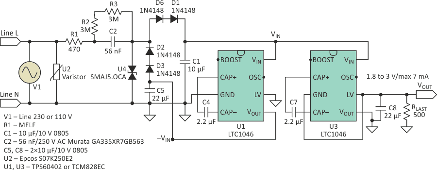

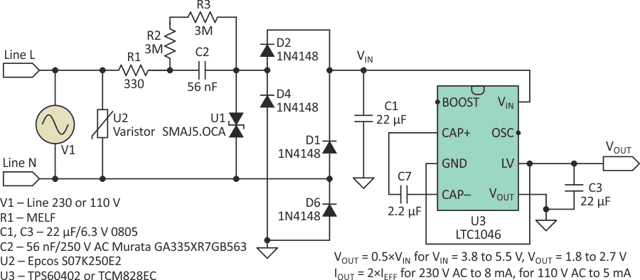

While this might be enough current for many very low-power microcontroller applications, it wouldn’t be sufficient for many of them. In the modified capacitive converter, diodes D1 and D2 have been replaced with a bridge comprising D1, D2, D3, and D6, which pumps current into capacitor C1 in every half-period of line voltage (Fig. 2). Varistor U2 and suppressor U1 are added for immunity against 2-kV surge and the burst testing procedure of IEC61000-4-5.

I used the LTC1046, which has a model in SW-LTspice, for the simulation of the circuits model of the Q-pump. However, it is too expensive for many situations, so you can use the TPS60402 or TMC828EC, which have the same functionality but are cheaper.
Therefore, there is only a very short time when the charge from C1 has to supply the rest of the circuit. The circuit has been simulated using LT-Spice version 4.19, as well as built and tested (Fig. 3).
C1 has to supply the rest of the circuit of Figure 2 for very short periods.
Figure 3. C1 has to supply the rest of the circuit of Figure 2 for very short periods.

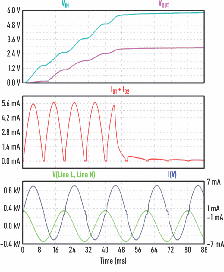

U3 is the capacitor-based charge pump, a very cheap, small (SOT23-6), and very efficient IC for small currents. In the step-down charge pump connection, it produces output voltage VOUT = 0.5 × VIN and corresponding output current IOUT = 2 × IIN. With the same 56-nF X2 capacitor for C2, we get IOUT_EFF = 8.0 mA for the 230-V ac line and IOUT_EFF = 4.6 mA for the 110-V ac line. This should be sufficient for most modern microcontrollers with a supply voltage range between 1.8 V and 2.7 V.

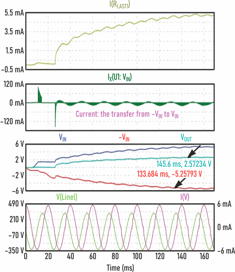

This results in the same properties in this rectification circuit as with bidirectional rectification using a diode bridge. Figure 5 shows the simulated results and the change of current polarity of charge pump U1’s VIN pin.
The startup and normal operation of the circuit at 230 V ac shows the change of current polarity on the VIN of charge pump U1 with a cycling period of 5 ms and 15 ms.
Figure 5. The startup and normal operation of the circuit at 230 V ac shows the

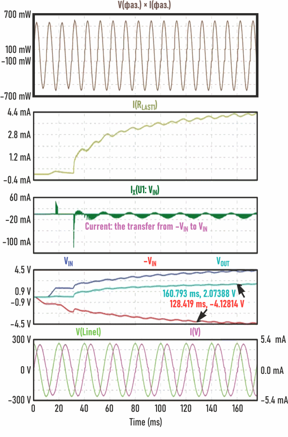

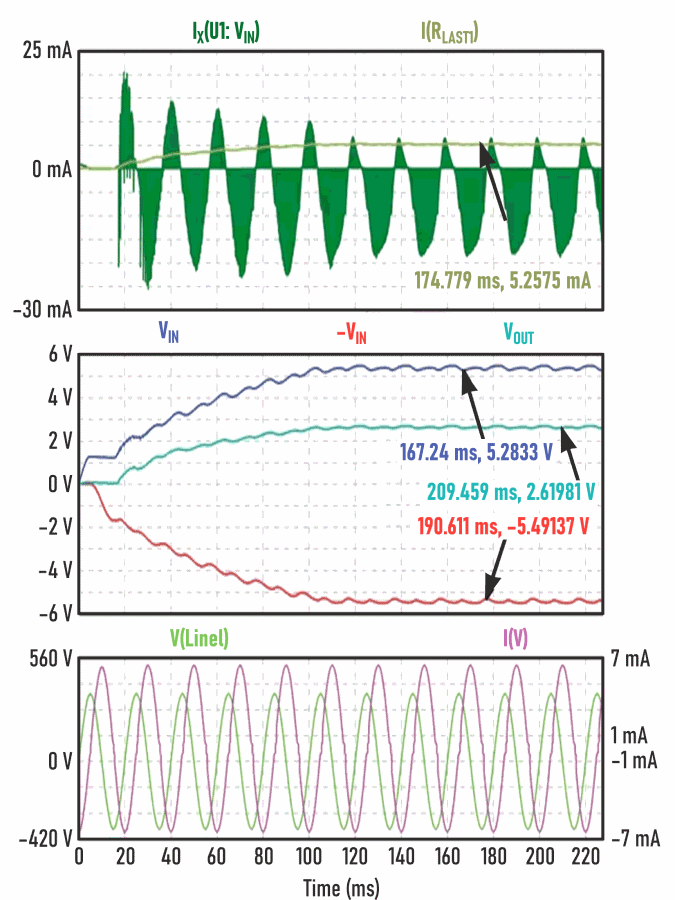

The circuit of Figure 5 has been simulated and tested at the worst-case line voltage of 230 V ac ±20% (Fig. 6).
а) Осциллограммы критических точек схемы при запуске и во время нормальной работы при низком напряжении сети 184 В (а) и высоком напряжении сети 260 В (б) демонстрируют плавное включение и последующую стабилизацию.
б) The waveforms of critical circuit points at startup and during normal operation of the circuit at a low line-voltage of 184 V ac (a) and a high line-voltage of 260 V ac (b) show smooth power-on transition and subsequent regulation.
Figure 6. The waveforms of critical circuit points at startup and during normal operation of
All results meet the requirements for most modern MCUs with respect to 2013 ErP Standby Power Regulation (see Table 1).
