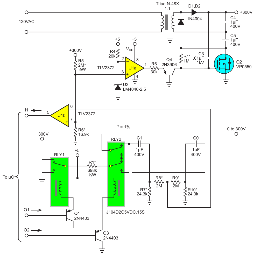

The 300 volt, 4 second, Shannon decoder DAC
Stephen Woodward
300 volt, 4 second, self-calibrating Shannon decoder DAC
Figure 1
19 Kb
Figure 1. The 300 volt, 4 second, Shannon decoder DAC
