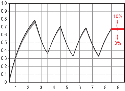

The effect of a 10% T = RC error producing a ~2% = 5 LSB conversion error

Figure 3. The effect of a 10% T = RC error producing a ~2% = 5 LSB conversion error
