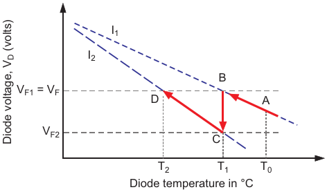

Operating principle of the …
Operating principle of the direct RMS readout thermometer

Circuit's RMS output is linearly proportional to temperature over wide range
Figure 1:
9 Kb
Figure 1:. Operating principle of the direct RMS readout thermometer
