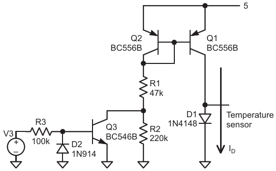

Switched constant-current source
Richard O. Ocaya
Circuit's RMS output is linearly proportional to temperature over wide range
Figure 2:
13 Kb
Figure 1:. Operating principle of the direct RMS readout thermometer
Figure 2:. Switched constant-current source
Figure 3:. Functional circuit with RMS output directly proportional to temperature
