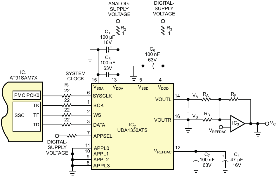

This scheme implements three-phase …
This scheme implements three-phase DDS (direct digital synthesis) with few components. The code in the ARM processor provides the ability to incorporate arbitrary frequency, phase, and amplitude adjustments with 16-, 18-, or 20-bit resolution
S Gonzalez
Low-cost digital DAC provides digital three-phase-waveform synthesis
