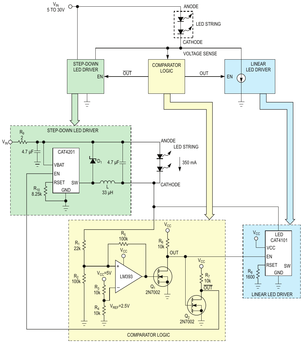

Linear and switcher LED supplies combine, overcome disadvantages of each topology
Figure 1. The LM393 comparator monitors the LED string's low-side voltage and enables either the buck regulator (CAT4201) or the linear regulator (CAT4101)
Figure 2. The linear/buck current sink extends the compliance range for current regulation down to a lower supply voltage (below 8 V), compared with the buck regulator alone, and reduces EMI with low battery. As a result, the LEDs can remain on under low-battery co
