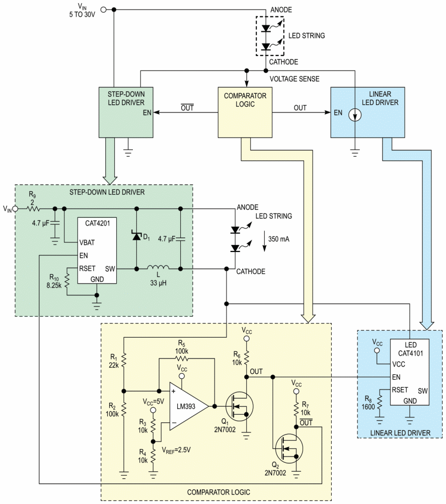

The circuit described here selects each LED driver independently with adjustable threshold voltages when transferring between the switching and linear modes, with additional hysteresis for a smooth changeover. Figure 1 shows the schematic using CAT4201 350-mA buck and CAT4101 1 A, constant-current LED drivers; the comparator logic is also shown. Unlike the more common buck topology, with a high-side switch and a low-side diode, the CAT4201 swaps those devices.
| Figure 1. | The LM393 comparator monitors the LED string’s low-side voltage and enables either the buck regulator (CAT4201) or the linear regulator (CAT4101).  |
As with a typical buck switcher, when the switch turns on, the current increases through the inductor, L, and the LEDs until it reaches a peak value equal to twice the average LED current; then the switch turns off. The charged inductor forces the current to continue to flow through the Schottky diode, D1, and the LEDs until it drops to zero; the cycle then repeats. This switching operation is referred to as boundary conduction mode.
The R1/R2 resistor divider produces V+ at a fraction of the cathode voltage. If the comparator (LM393) input voltage is greater than a fixed reference voltage of 2.5 V, then the output is high; OUT is low, disabling the linear driver and enabling the buck converter. If V+ is lower than the reference voltage, the comparator output is low and the linear driver is enabled, while the buck converter is disabled. The feedback resistor, R5, adds some 0.6 V hysteresis, such that once the cathode voltage rises above 3.6 V, the buck turns on; as the cathode voltage falls below 3 V, the linear driver takes over. Note that if the other half of the LM393 is not used for another LED power supply, good design practice dictates that all unused input and output pins on the LM393 be tied to ground.

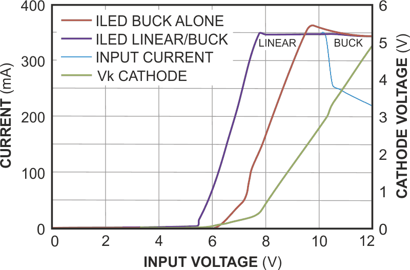

Figure 2 shows the LED current regulation for the buck alone and the combination linear/buck driver. The linear/buck driver extends the LED current regulation down to a lower supply voltage below 8 V, compared with the buck alone, allowing the LEDs to remain on, even as the battery voltage drops further. For a supply voltage below 11 V, the buck alone loses its accuracy and also generates higher switching ripple current back into the supply. The lower-frequency ripple current is more difficult to suppress with an EMI filter. On the other hand, under the same supply-voltage range, the linear driver provides better regulation and noise-free operation.
