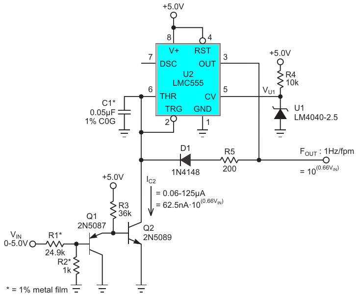

Adding one resistor improves anemometer analog linearity to better than ±0.5%

Figure 3. Anti-log linearizing VFC
Figure 4. Airspeed response linearity of Figure 3's anti-log VFC is better but still un-terrific
Figure 5. Adding one resistor (R6) and adjusting another (R1) ironed out the bump in Figure 3's analog linearizing
Figure 6. Improved analog linearity resulting from VFC modifications shown by overlaid blue and black lines
