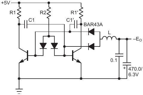

Added inductance to the output of Figure 1 to improve converter efficiency

Using an inductor to improve an existing design
Figure 1. Simple local low-noise voltage converter that can be used when a simple negative supply of low voltage is required
Figure 2. Added inductance to the output of Figure 1 to improve converter efficiency
