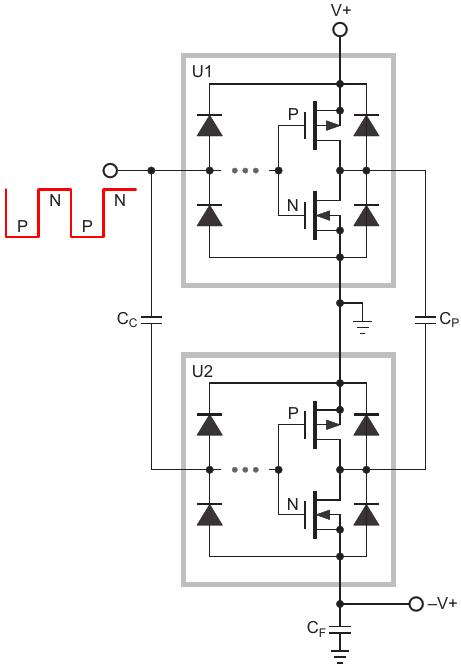

Voltage inverter uses gate's output pins as inputs and its ground pin as output
Figure 2
9 Kb
Figure 1. Simplified schema of typical basic CMOS gate I/O circuitry showing clamping diodes and complementary FET switch pair
Figure 2. Simplified topology of logic gates comprising voltage inverter, showing driver device (U1), switch device (U2), and coupling (C
C
), pump (C
P
), and filter (C
F
) capacitors
Figure 3. Complete voltage inverter: 100 kHz pump clock (set by R1C1), Schmidt trigger and driver (U1), and commutator (U2)
