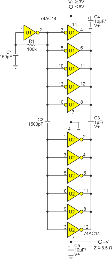

That’s the theory. Translation of Figure 2 into practice as a complete voltage inverter is shown in Figure 3. It’s really not as complicated as it looks.
Complete voltage inverter: 100 kHz pump clock (set by R1C1), Schmidt trigger and driver (U1), and commutator (U2).
Figure 3. Complete voltage inverter: 100 kHz pump clock (set by R1C1),
A 100 kHz pump clock is output on pin 2 of 74AC14 Schmidt trigger U1. This signal is routed to the five remaining gates of U1 and the six gates of U2 (via coupling cap C2). Negative charge transfer occurs through C3 into U2 and accumulates on filter cap C5.
Even though the Schmidt hysteresis feature isn’t really needed for U2, the same type is used for both chips to improve efficiency-promoting synchronicity of charge-pump switching.
Some performance specs (V+ = 5 V):
  • Impedance of V- output: 8.5 Ω
  • Maximum continuous load: 50 mA
  • Efficiency at 50 mA load: 92%
  • Efficiency at 25 mA load: 95%
  • Unloaded power consumption: 440 µW
  • Startup time < 1 millisecond
