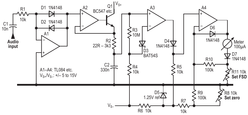

We take the log of the input signal; its peak level is captured on C2, which is discharged slowly and linearly; and temperature- and level-corrections are applied in the current source which drives the meter
