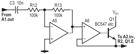

Figure 4. Extra components can be added for full-wave detection
