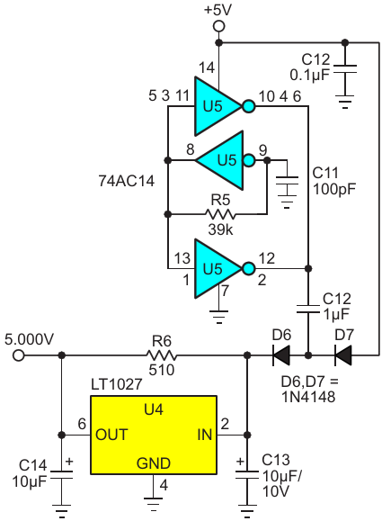

A 250-kHz diode charge …
A 250-kHz diode charge pump Rail booster bringing rail to 8 V which is then regulated down to a precision 5.000 V reference by U4

Figure 2. A 250-kHz diode charge pump Rail booster bringing rail to 8 V which is then regulated down to a precision 5.000 V reference by U4
