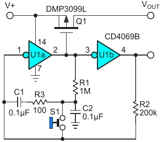

Flip/flop-free debounced push ON …
Flip/flop-free debounced push ON push OFF toggling with power-on reset and low parts count
Stephen Woodward
Flip ON flop OFF without a flip/flop
Figure 1
11 Kb
Figure 1. Flip/flop-free debounced push ON push OFF toggling with power-on reset and low parts count
