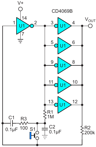

Do something useful with the other 2/3rds of U1, eliminate Q1 for loads of less than 10 mA, and gain short-circuit protection for free

Figure 3. Do something useful with the other 2/3rds of U1, eliminate Q1 for loads of less than 10 mA, and gain short-circuit protection for free
