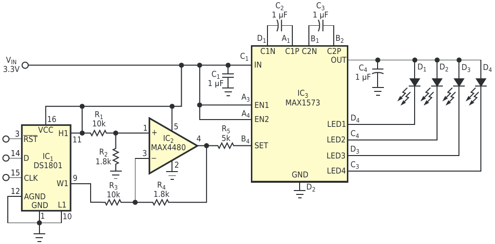

This circuit provides a …
This circuit provides a logarithmic-function dimming capability for white LEDs

White-LED driver provides 64-step logarithmic dimming
Figure 1
19 Kb
Figure 1. This circuit provides a logarithmic-function dimming capability for white LEDs
