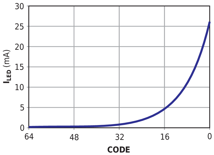

IC1 is a digital potentiometer with a logarithmic taper and an analog-voltage wiper. Each wiper tap corresponds to 1 dB of attenuation between H1 and W1 (pins 11 and 9). The IC contains two potentiometers controlled by a 16-bit code via a three-wire serial interface. To set the LED current, drive RST high and clock 16 bits into the D terminal of IC1, starting with the LSB. Each pulse at CLK enters a bit into the register. The circuit uses only one potentiometer, so bits 0 through 7 are “don't-care” bits. Bits 8 through 14 determine the wiper position: Bits 8 through 13 set the code, and bit 14 is “mute.” (Logic one at bit 14 produces the lowest possible output current by setting the left side of R5 at approximately 0.599 V.) After entering all 16 bits, enter the code and change the brightness level by driving RST low. Figure 2 shows the logarithmic relationship between an LED current and the potentiometer's input code.
LED current versus input code changes for the circuit in Figure 1.
Figure 2. LED current versus input code changes for the circuit in Figure 1.
