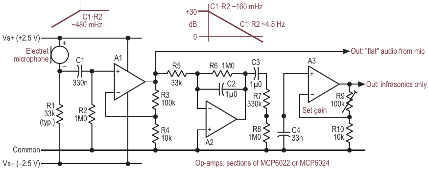

Simple equalization can extend the low-frequency response of an electret microphone down to well under 1 Hz

Revealing the infrasonic underworld cheaply. Part 1 - Seeking a solution
Figure 1. Simple equalization can extend the low-frequency response of an electret microphone down to well under 1 Hz
Figure 2. The response of Figure 1's circuit to air-pressure changes at different frequencies
