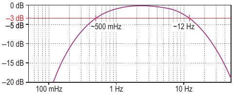

The response of Figure 1's circuit to air-pressure changes at different frequencies

Figure 2. The response of Figure 1's circuit to air-pressure changes at different frequencies
