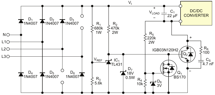

A three-phase rectifier uses a switched IGBT and a capacitor to reduce the voltage to standard offline dc/dc converters
AuthorsCarlos Castro-Miguens, José Benito Castro-Miguens, Marcos Pérez-Suárez, Alberto Abal Pena
Main DocumentArticle «Use a three-phase rectifier and voltage reducer for offline single-phase supplies»
DescriptionFigure 1
File Format / SizePDF / 19 Kb
