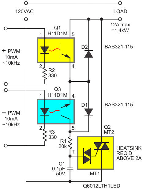

Q1 and Q3 provide …
Q1 and Q3 provide independent triggering-time constants for opposite polarity half-waves
Stephen Woodward
Independent control of thyristor half-wave firing angles via PWM
Figure 1
17 Kb
Figure 1. Q1 and Q3 provide independent triggering-time constants for opposite polarity half-waves
Figure 2. Thyristor conduction angle R versus PWM D, where the y-axis is in radians and the x-axis is the unitless D
Figure 3. The PWM D versus the desired conduction angle R. The y-axis is the D, and the x-axis is in radians
