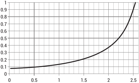

The PWM D versus …
The PWM D versus the desired conduction angle R. The y-axis is the D, and the x-axis is in radians

Figure 3. The PWM D versus the desired conduction angle R. The y-axis is the D, and the x-axis is in radians
