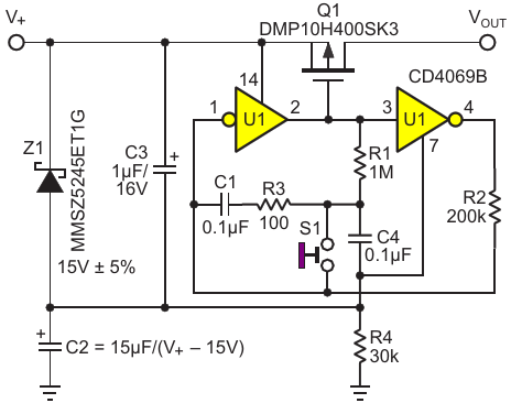

Flip ON/Flop OFF referenced …
Flip ON/Flop OFF referenced to the V+ rail. If V+ < 15 V, then set R4 = 0 and omit C2 and Z1. Ensure that C2's voltage rating is > (V+ - 15 V) and if V+ > 80 V, R4 > 4 V+

Flip ON Flop OFF: high(ish) voltages from the positive supply rail
Figure 1
