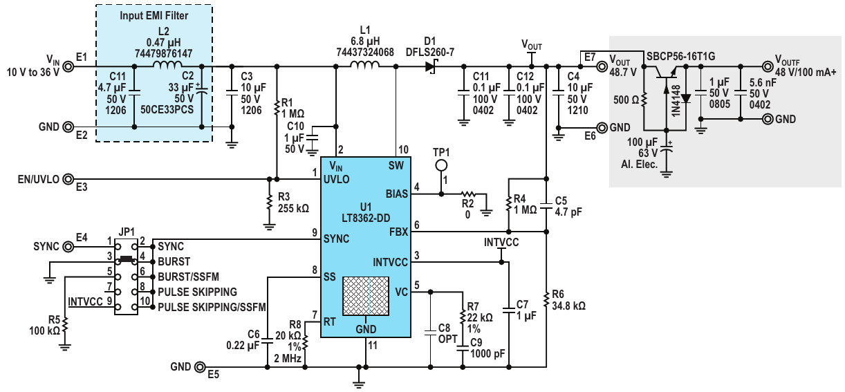

A capacitance multiplier (gray) …
A capacitance multiplier (gray) added at the output to the original circuit suppresses audio-frequency noise produced by the switching regulator
Thomas Mosteller, Christopher Jarboe
Ultra-low-noise phantom microphone supply uses tiny DC-DC converter plus capacitor "trick"
Figure 2
29 Kb
Figure 1. This demonstration circuit, DC2628, is the basis for the phantom power supply
Figure 2. A capacitance multiplier (gray) added at the output to the original circuit suppresses audio-frequency noise produced by the switching regulator
