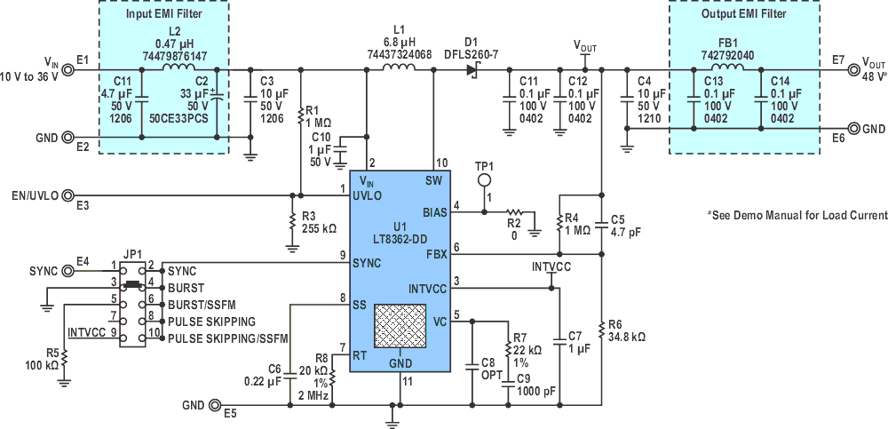

This very high-performance supply is built using the LT8362 boost converter, which features a 60-V, 2-A switch and operation up to 2 MHz, and comes in a package as small as 3 × 3 mm. The circuit is based on the standard LT8362 DC2628A demo board (Fig. 1).
This demonstration circuit, DC2628, is the basis for the phantom power supply.
Figure 1. This demonstration circuit, DC2628, is the basis for the phantom power supply.
The input EMI filter on the demo board, aided by the switching inductor, does a good job of taking care of high-frequency noise that appears in series with the input. The situation isn’t as good on the output. The output EMI filter effectively suppresses noise in the megahertz region, but it has little effect on noise in the audio range. This noise mostly arises due to the 30X gain in the feedback loop, amplifying the reference noise of the LT8362.

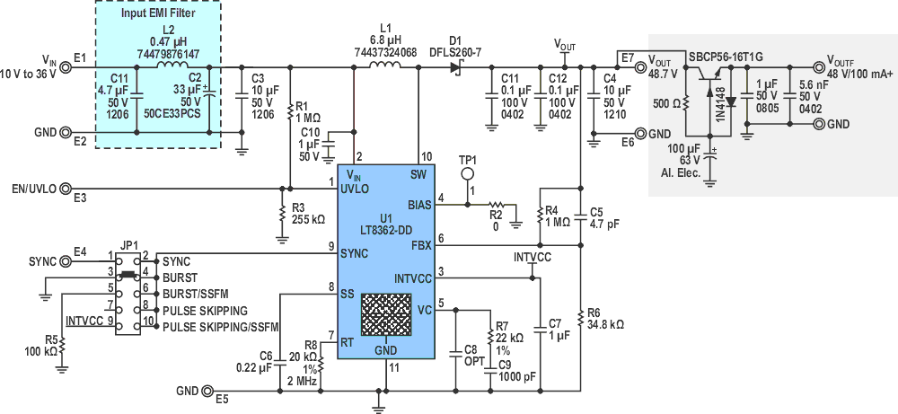

Instead, a better approach is to make the output capacitors seem bigger than they really are. This can be accomplished with an” old-school” technique called capacitance multiplication, a simple circuit in the gray shaded area of Figure 2.
A capacitance multiplier (gray) added at the output to the original circuit suppresses audio-frequency noise produced by the switching regulator.
Figure 2. A capacitance multiplier (gray) added at the output to the original circuit suppresses audio-frequency noise produced

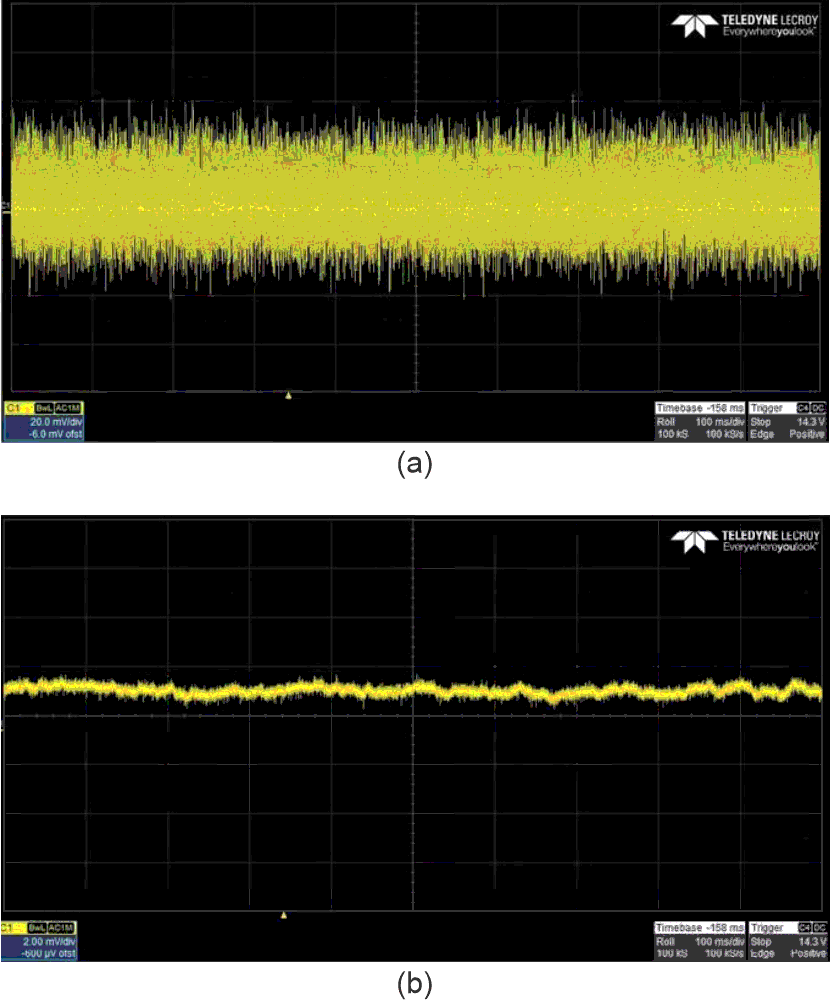

Here, the 100-µF capacitor controls the ripple on the base current, so its effect on the collector current is amplified by the beta of the NPN transistor. The effect is dramatic. Figure 3a shows the output of the LT8362 circuit at C4 (before the filter) with a 1-kΩ load (50 mA).
The signal before and after filter: The output of the boost regulator presents about 0.2% noise content when measured at C4 (before filter) (a). The post-filter output contains a much-improved noise content of just 0.002% (b).
Figure 3. The signal before and after filter: The output of the boost regulator presents
The noise is roughly 80 mV p-p, which represents about 0.2% noise content. While this may be sufficient for noncritical applications, the output after the filter is substantially better at approximately 1 mV p-p (Fig. 3b). This represents about 0.002% or 20-ppm noise content, which is sufficiently low for even the most demanding applications. Figure 4 shows the benchtop setup.

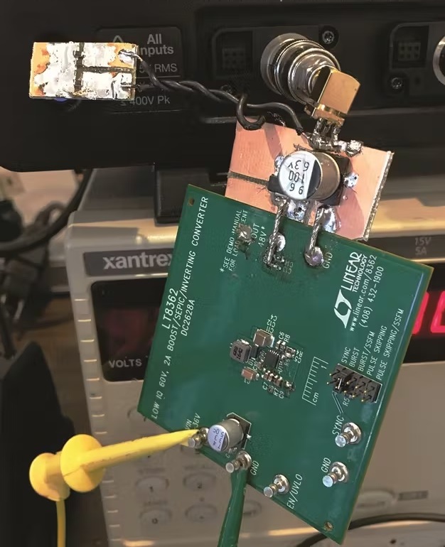

The benchtop setup of the clean phantom power supply using the DC2628 demonstration circuit shows the added-on filter.
Figure 4. The benchtop setup of the clean phantom power supply using the DC2628
The SBCP56-16T1G transistor was chosen for its high VCEO (80 V) and high beta at low currents. The high beta gives the capacitance multiplier its high apparent capacitance and relatively constant drop as output current varies. The output voltage drops from 47.8 V with a 2-kΩ load to 47.5 V at 500-Ω load, which is sufficient for microphone applications. Don’t substitute another transistor without testing for noise and regulation.
The tests were run with 16-V input, but the performance will be similar with 12 V to 24 VIN. Some applications may require boosting from 5 V, which can be accomplished by decreasing the LT8362’s switching frequency from 2 MHz to 1 MHz to allow for the 75-ns minimum off time. This would also require increasing L1 to about 10 µH to 15 µH and doubling up on bulk-output capacitor C4 to maintain equivalent performance.
