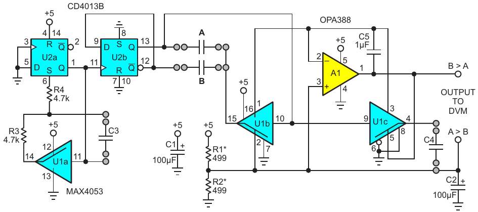

Flip-flop U2b generates complementary …
Flip-flop U2b generates complementary excitation of the A and B capacitors under test

Capacitor matchmaker
Figure 1. Flip-flop U2b generates complementary excitation of the A and B capacitors under test
Figure 2. The U1aU2a multivibrator waveforms; the green waveform is the R3R4 junction, and the red waveform is U2 pin 6. The frequency is 0.1 mHz/C3
