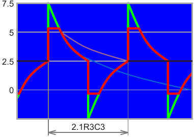

The U1aU2a multivibrator waveforms; …
The U1aU2a multivibrator waveforms; the green waveform is the R3R4 junction, and the red waveform is U2 pin 6. The frequency is 0.1 mHz/C3

Figure 2. The U1aU2a multivibrator waveforms; the green waveform is the R3R4 junction, and the red waveform is U2 pin 6. The frequency is 0.1 mHz/C3
