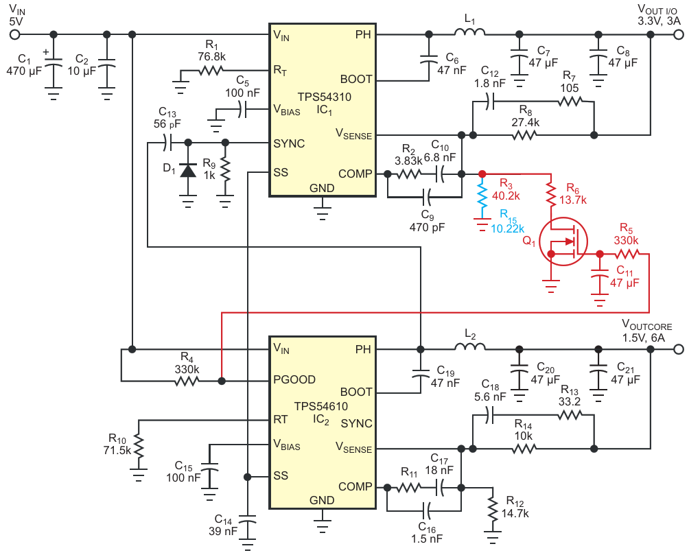

This circuit provides ratiometric …
This circuit provides ratiometric (delete red path and components) or simultaneous power-up sequencing

Circuit controls ratiometric or simultaneous power-up of multiple rails
Figure 1
22 Kb
Figure 1. This circuit provides ratiometric (delete red path and components) or simultaneous power-up sequencing
Figure 2. This graphic shows measurement results for the ratiometric implementation
Figure 3. These curves, distinctly different from those in Figure 2, show simultaneous-sequencing results
