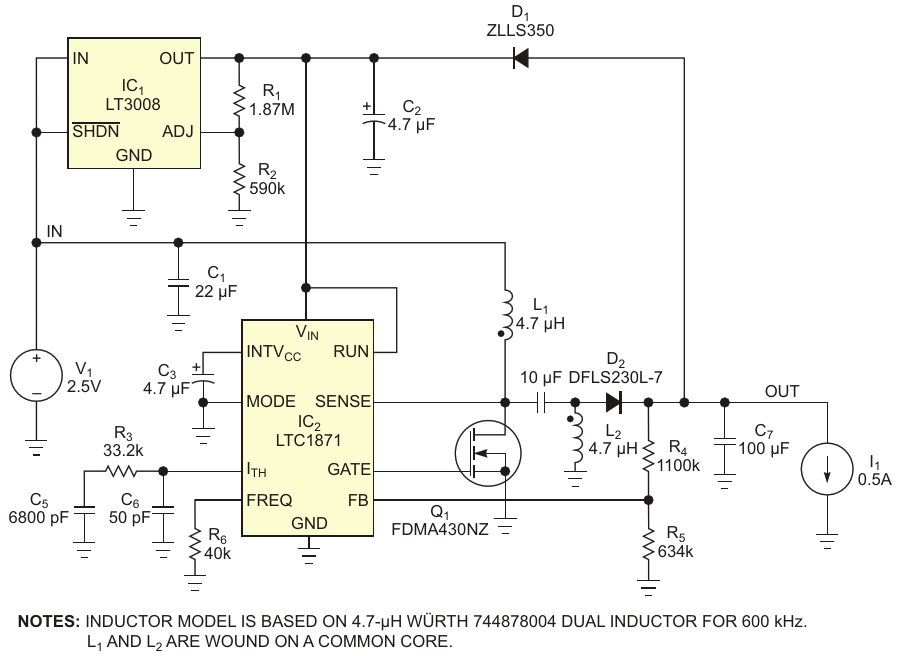

The power supply can …
The power supply can provide a 3.3 V output from 2.5 to 20 V input voltages. It needs 2.5 V to start

Power supply accepts wide input-voltage range
Figure 1
20 Kb
Figure 1 . The power supply can provide a 3.3 V output from 2.5 to 20 V input voltages. It needs 2.5 V to start
