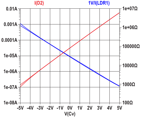

The simulated resistance curve …
The simulated resistance curve and LED2 current at 20 °C and 40 °C

Figure 1. An exponential vactrol drive where a reference LED is used to convert a linear control voltage into an exponential current, and two matched LEDs are used for temperature compensation
Figure 2. The simulated resistance curve and LED2 current at 20 °C and 40 °C
