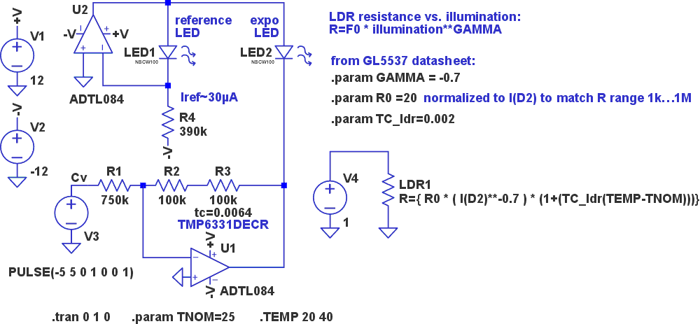

A vactrol circuit
Usually, a pair of transistors (Ref. 2) is used to convert a linear control voltage into an exponential current. In the case of a vactrol, however, the pair of transistors can be replaced by the LED itself, which is like any diode a voltage-controlled exponential current source.
For temperature compensation, two matched LEDs are required, similar to the transistor circuit.
Figure 1 shows the simulated circuit of the exponential vactrol control.
An exponential vactrol drive where a reference LED is used to convert a linear control voltage into an exponential current, and two matched LEDs are used for temperature compensation.
Figure 1. An exponential vactrol drive where a reference LED is used to convert a linear control voltage into an exponential current,
The LED1 is operated with IREF = –V/R4. At CV = 0, the current in the vactrol LED2 is identical, and the resistance of the LDR is set to the middle of the desired resistance range via IREF, here about 30 µA.
As CV increases, the voltage at the cathode of LED2 decreases, but the voltage between the anode and cathode increases so that the LED current increases exponentially.
With a negative CV, the voltage across LED2 decreases accordingly, so that the LED current decreases exponentially. The range of the LDR resistance is determined by summing amplifier U1’s gain. In practical applications, a range of ~1 MΩ (CV = –5 V) to 1 kΩ (CV = +5  V), is used, so that a VCF can be tuned from 20 Hz to 20 kHz.
Thermistor R3 improves the temperature drift of the LED current. Still, the LDR’s temperature dependence remains at approximately 0.2%/K, which makes the vactrol circuit less suitable for high-end VCOs.
For other applications (VCF, VCA), the temperature drift is good enough, and in most cases, the thermistor can be omitted.
