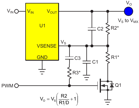

PWM nonlinearity that software can't fix
Figure 1
14 Kb
Figure 1. PWM programs V
O
linearly
Figure 2. PWM programs V
O
nonlinearly
Figure 3. The 8-bit PWM setting versus D = X/255. The left axis (blue curve) is V
O
. The right axis (red curve) is V
O
volts increment per PWM least significant bit (LSBit) increment
Figure 4. The impact of making R1
A
80% of R1
ABC
O
O
volts increment per PWM LSBit increment
